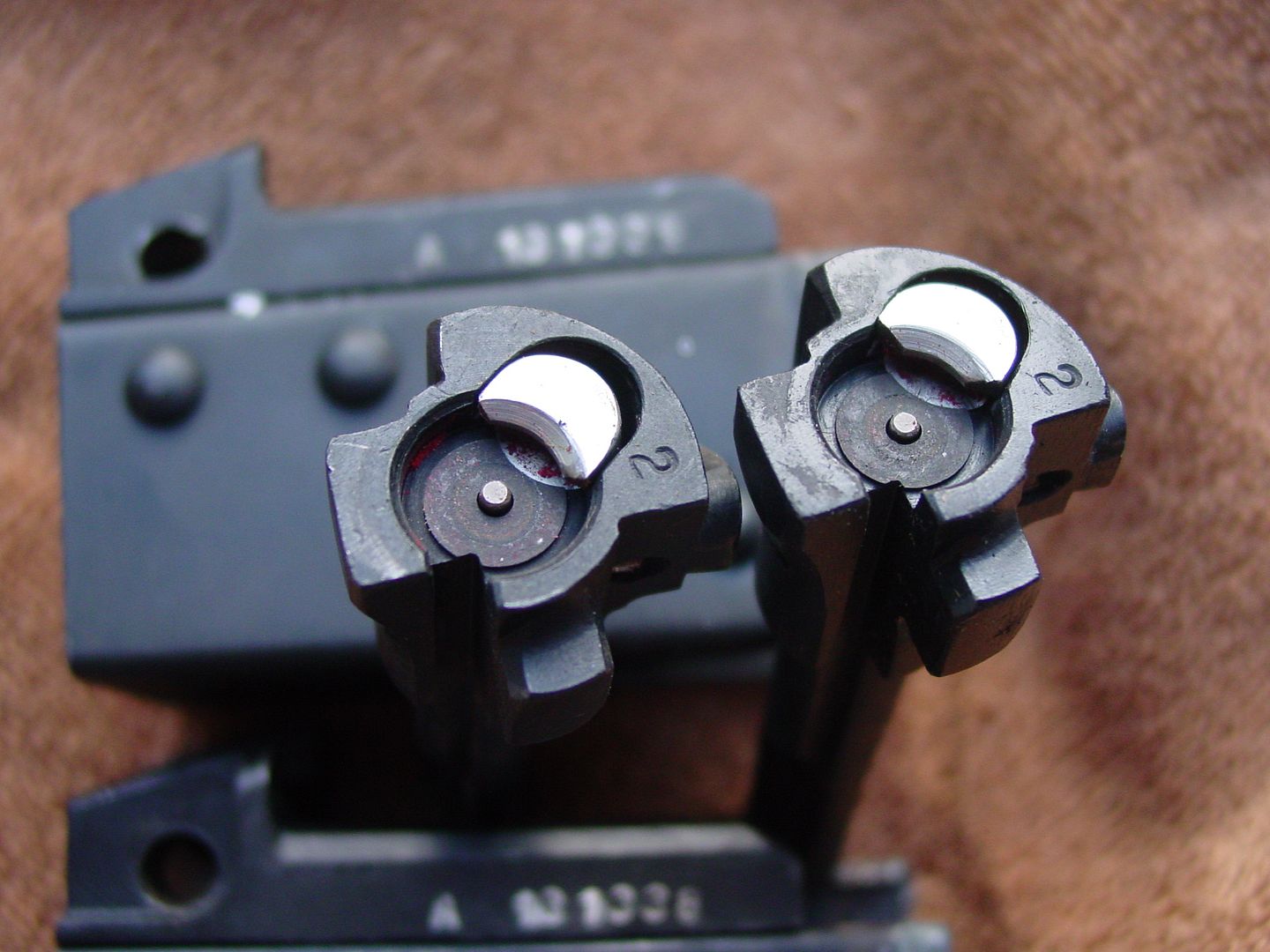

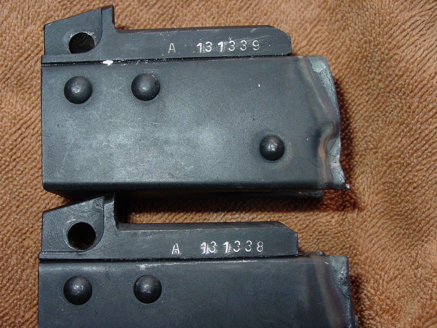

Found some markings in these pics...
Hope it helps!

I'm convinced the number on the bolt face is a bolt size number. So far most of mine are numbered with 2 but I do have one marked 0.

The bolt numbers go from 1 to 4 or 5 I believe and they represent within the assembly line when they were checking headspace which bolt they used.
If 1 didn't go then it went to 2 or 3 or 4.
It happens but it was very rare.
Hope it helps!
Hope it helps!

I read somewhere that number on the trunion is the year of manufacture. Mine has 77 marked with other marks.

A designates
1st series production
Looks like those are showing early 68 or late 67 production time.

A designates

For the underfolders?
My A series prefix UF kit has a number of cast barrel parts. Castings seemed to show up later rather than earlier. Even the UF trunnion is cast.
Feed ramp on the barrel -also known to be a later feature.
I was of the opinion that the cast parts appeared in the 1980's.
5.45x39mm posted Hungarian UF front trunnions.
Perhaps you are thinking AMD-65 with an A prefix?
